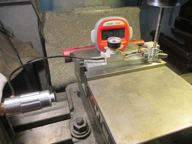

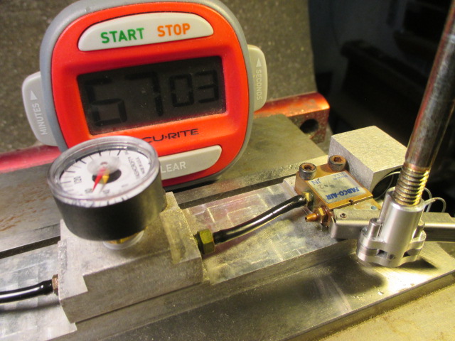

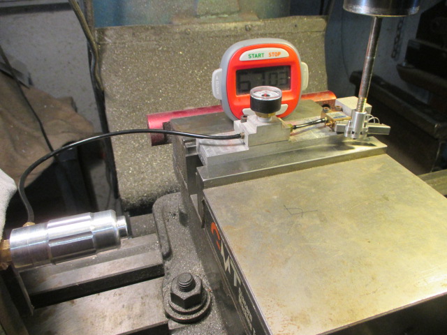

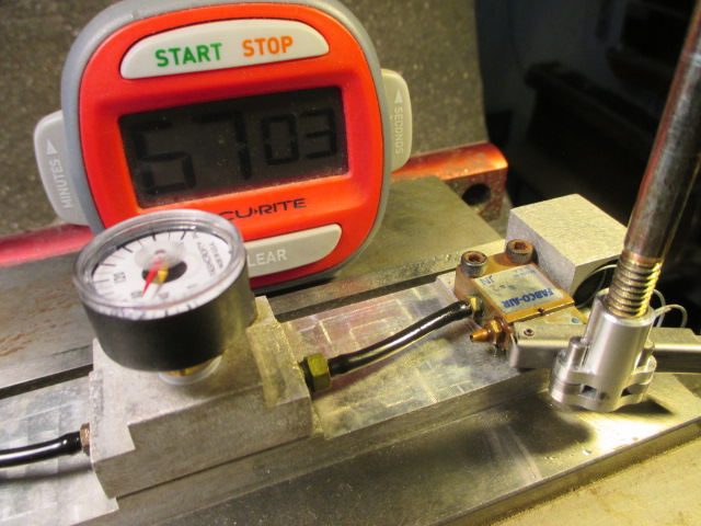

                          So I just finished up another round of testing today, here are the numbers.
                          *67 minute mechanical test (ran on my knee mill)
                          *Spindle speed is 660 rpm
                          *Two paddles on the actuator converts to 1320 rpms
                          *1320 rpms equal 22 cycles per second
                          *67 minute test time equals 88,440 cycles or 44.22 cases of paint. (I actually ran in excess of 90K off the clock)
                          *LPR set at about 58 psi input
                          *LPR running test is 58-52 psi (-6 psi deviation which is tighter than my FG-LPR)
                          I found zero leaks or hiccups with the LPR, the only issue was with the Fabco MSV2. I had to stop 23 minutes in to oil the valve, a few shots of oil and we were back in business.
                          Next step is to disassemble and inspect, then move on to the 3rd round of testing.
                          Here's a short clip of the test>
                          A few pictures of the test setup:
Name:	P90 LPR Test Setup 2.JPG
Name:	P90 LPR Test Setup 1.JPG
                            #43
                            I have a feeling that the post above is for my benefit
                            But, only 58psi input? Isn't the job of the LPR to take bottle pressure down to usable or working preasure or is that a typo? Cause the way i understand it, that people will be putting 800psi+ into the LPR and no one wants a failure of over pressurizing their setup, wbether it's the intial gas up or hapfway through the day.
                              • 8235
                              #44
                              58 psi is what the LPR is putting out at a stand still, not input pressure. The pressure gauge between the LPR and the MSV2 is to measure the output air of the regulator not the in coming air. The 58-52 psi shows the recovery rate at 22 cycles per second. 60 psi is typically the highest pressure people run the pneumag setups, I setup the T-Rex about 40 psi. (Lower pressures are faster)
                              Yes it easily handles all input pressures required by Automag builds.
                              Yes the post was for you but not the testing itself.
