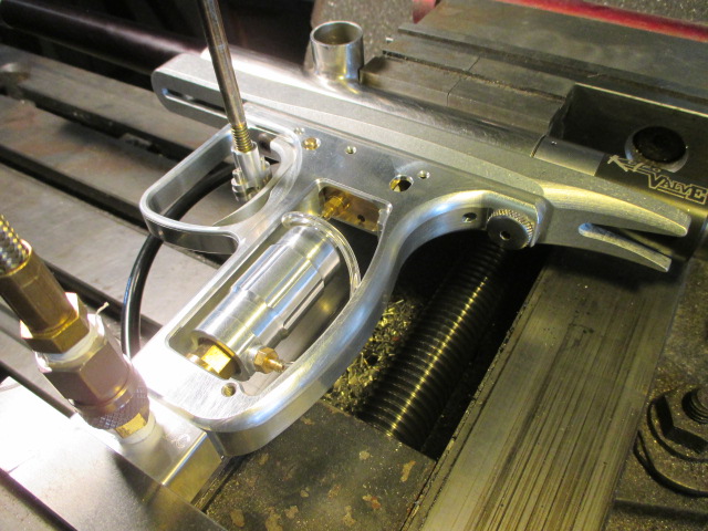

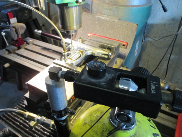

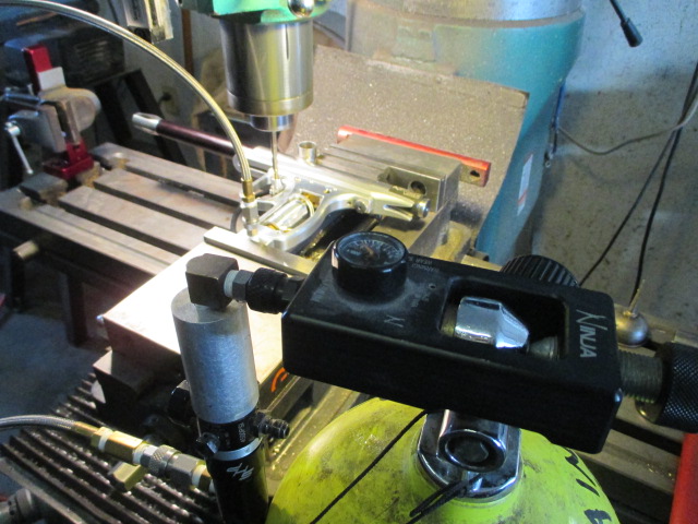

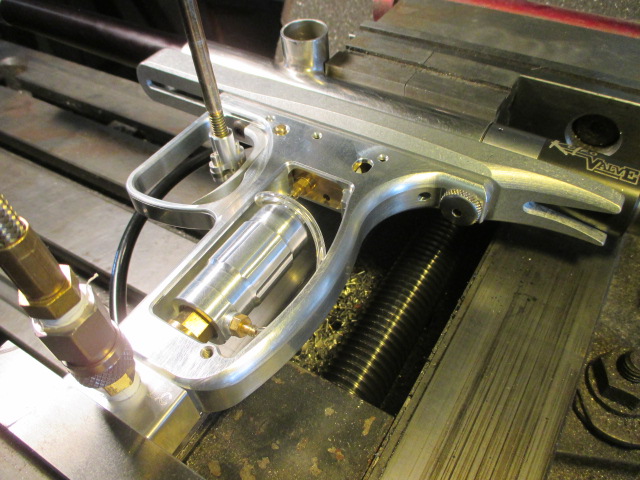

      Based strictly on the math and the motor specs on the knee mill this should be 22 cycles per second. It would be interesting to see what a sound file says.
      *AGD Retro Valve with RT On/Off
      *T-Rex
      *P90 LPR
      *Ninja Reg set at 925 psi
      (LPR set so there's no bounce)
      Here's a short clip>
      A few pictures of the test setup

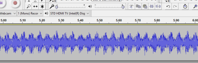

        Looks like just a hair shy of 24

          Holy cow, thanks PGP!

                        How big of a hassle is it to run this sound wave test? I've ran a higher cps test and am curious if the system is keeping up or if the paddles are out running the trigger.
                          It's super easy. I just exported the audio out of your video, pulled it up in Audacity (free) and zoomed in on a one second period. If you want me to do another one just post it up.
