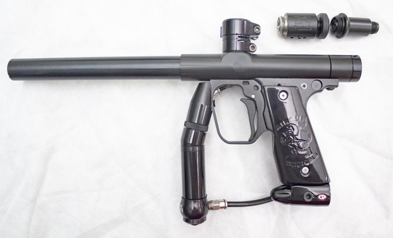

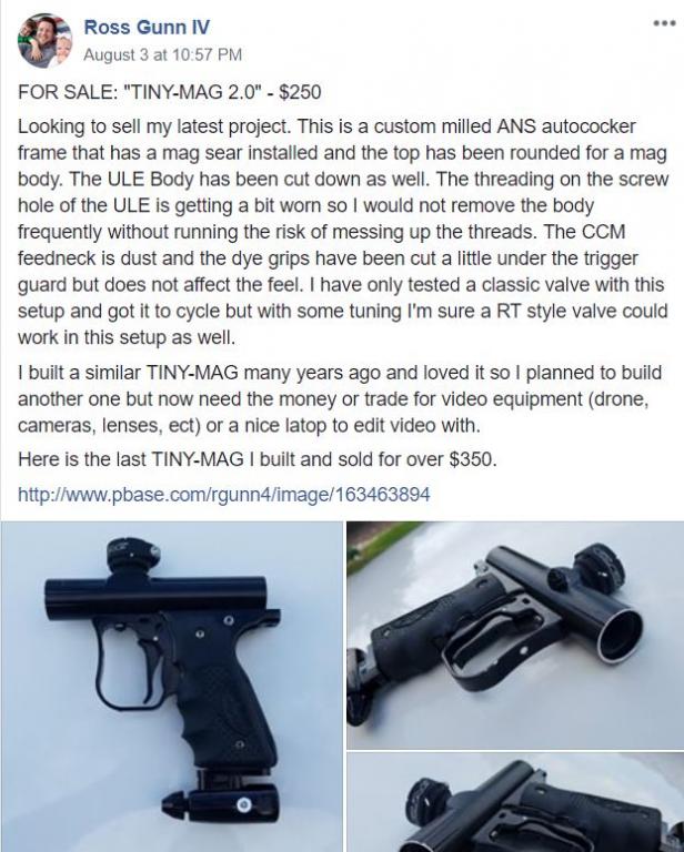

                        I've brought it up before, but I've never had a CAD for it. Not even my idea. Who was it that put the sear pin inside a cocker hinge frame? It was a truely 'micro' mag.
                        Saw it recently in the "AGD Automag Owners and Discussion B/S/T" Facebook Group:

                        Rather than combine the rail and body like X-Mags, a Deflator, or an XMT Evo, combine the grip and rail to really shrink things.

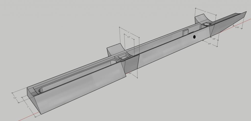

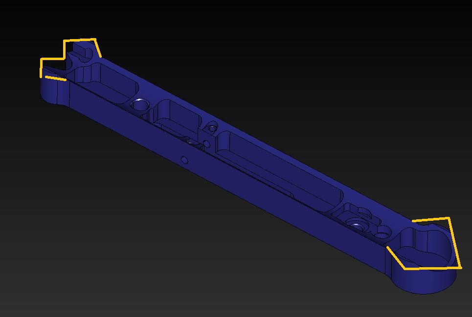

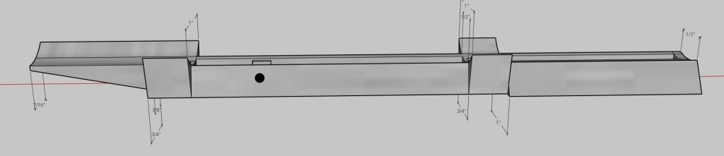

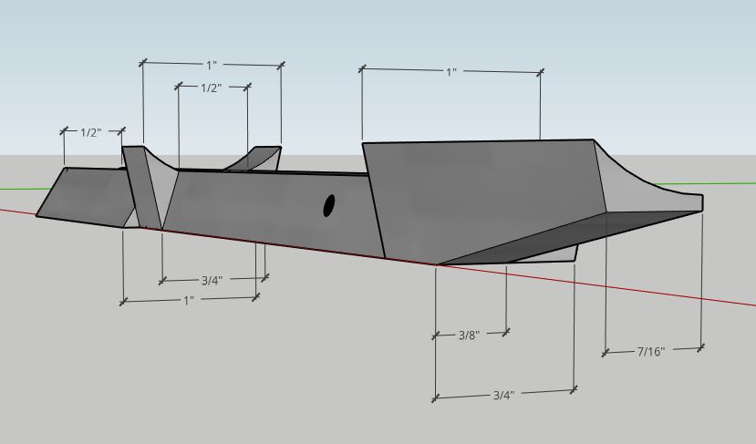

                          #162

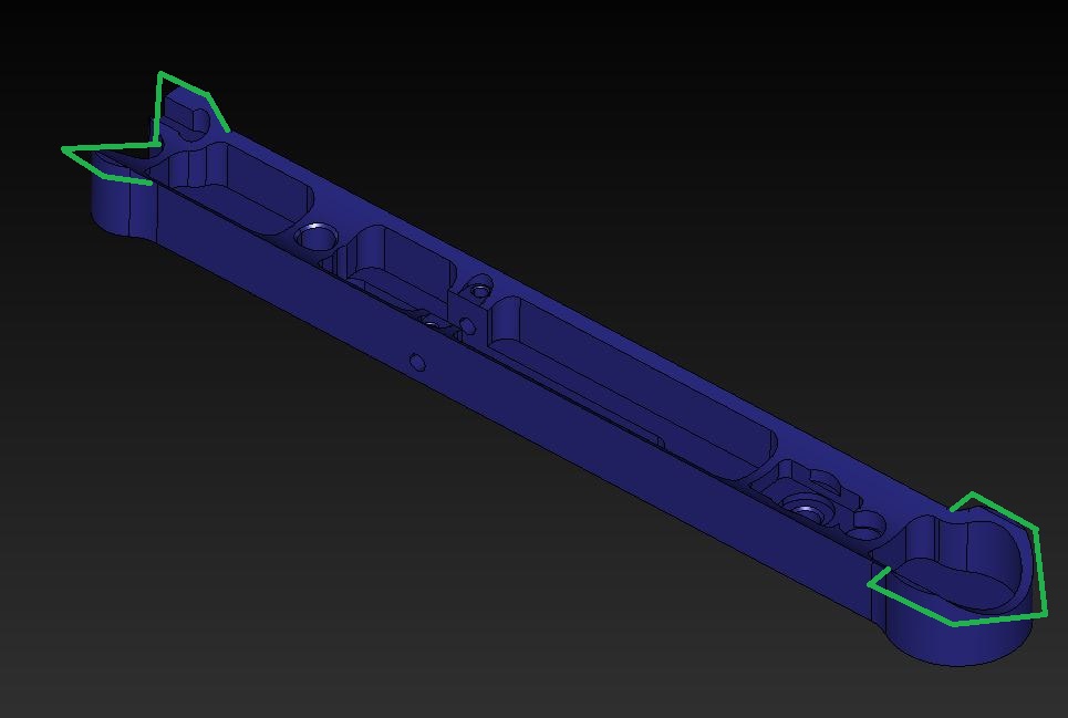

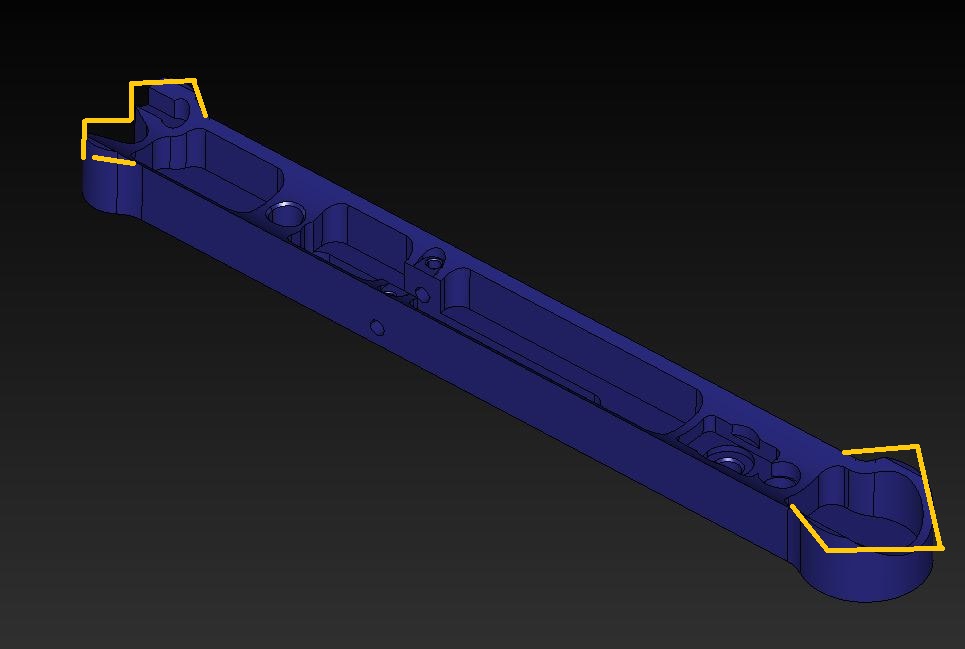

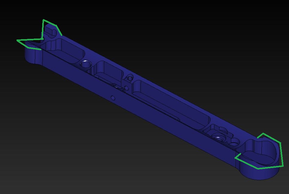

                          Ultralight Hybrid
                          The old style was a little narrow at .65" wide and left a little gap on a standard frame between the frame and rail. I widened this to .75" so it will match exact to the grip frame. I was also able to do away with the center bumps that were there for the sear pin.
                          Don't know if its too late, but with all the other things going on I forgot to revisit this design. Instead of being 'rounded off' at the ends like a 'dogbone', how about something more geometric and squared off at the front and back? I don't know about a full RT slot fore-grip (maybe, maybe not) but I'm thinking something with all 90 degree angles or maybe something in the shape of an "arrow"? Not sure what exact angles would work out best, but something along these lines...? I actually just picked up an original AM "dogbone" last week from Le Capitan Pinky, so looking at something different I guess. If you're at the "I think I've designed enough for now" point, no big deal.

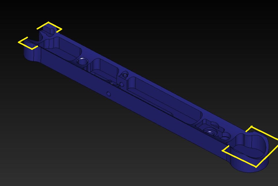

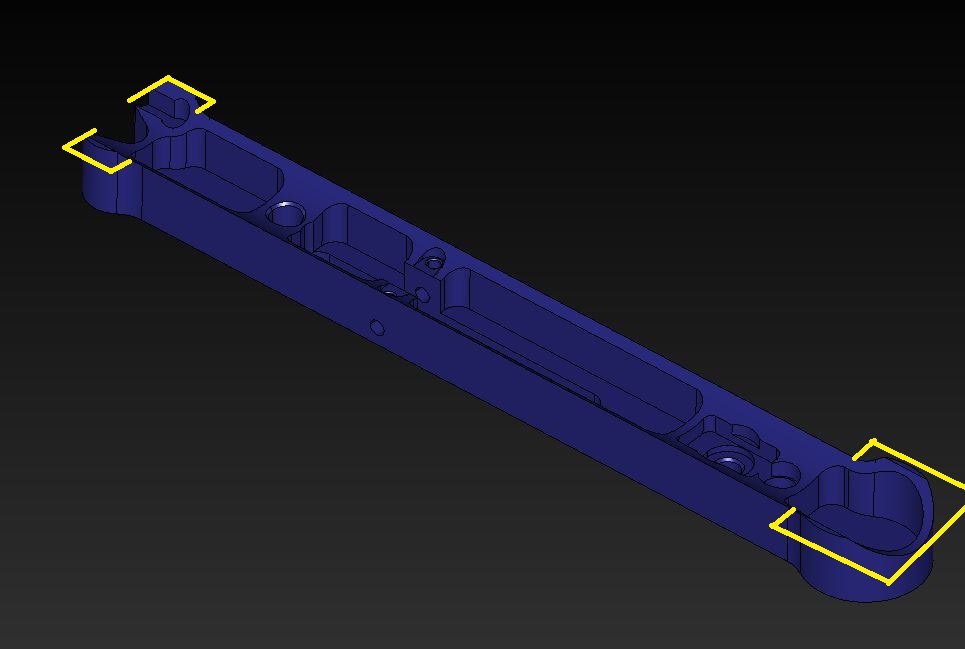

                            #163
                            In general, inside square or inside 90* cuts aren't doable or adds to many setups to make it viable or attractive to the machinist to want to do it. Any of those designs would need to be done in one setup, so looking from the top view consider the profile is being machined with a round cutter, all those 'inside' square corners will be rounded.
                            Nothing wrong with the ideas but I don't think they would be viable as as store item, I can machine a custom rail but there would be additional costs involved to do a one-off.

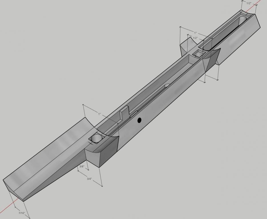

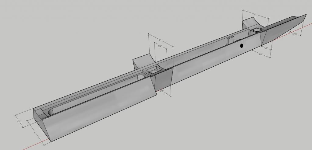

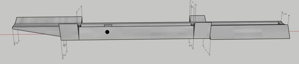

                              [ATTACH=CONFIG]100053[/ATTACH]
                              I've done one similar to this before, even carried it on my website, only sold two.

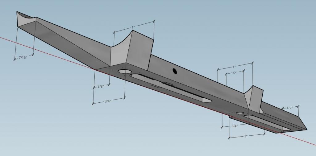

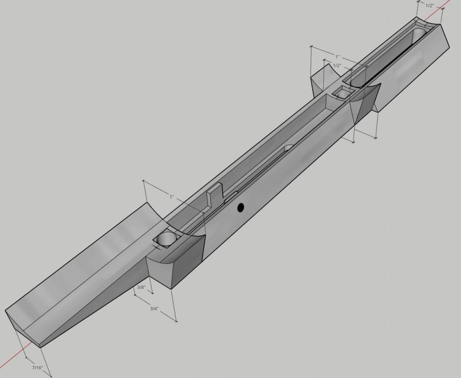

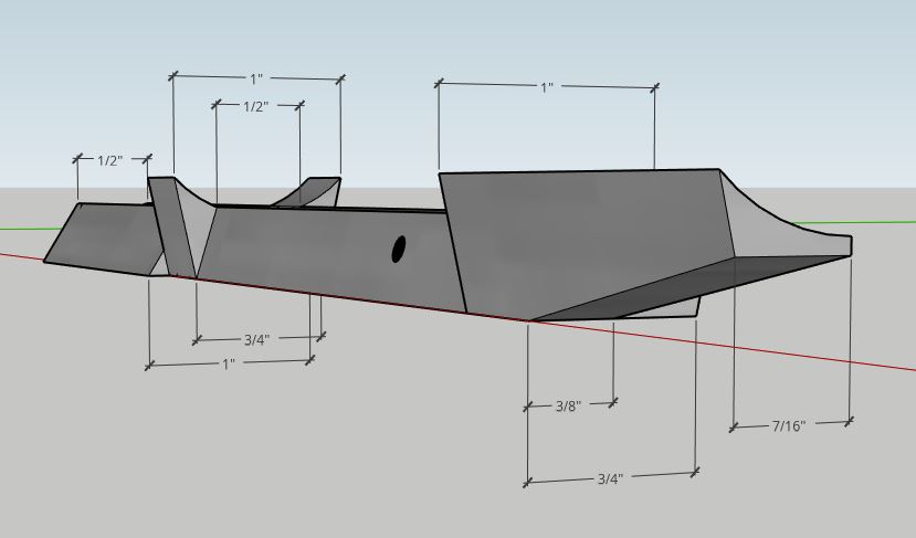

                                #165
                                I'm not at work so I couldn't whip it up in Inventor/Solidworks, but had an idea... needs to have the inside corners rounded off, maybe outside too. I was thinking maybe the front gets rounded off too somehow or something, but this is the general idea...
