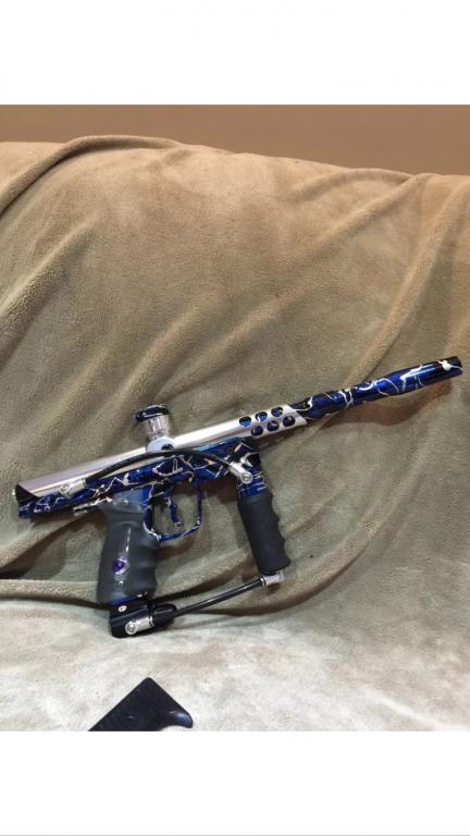

    Hi everyone ! I grew up playing paintball it was a family business. Then I went away to college,got married, sold all my gear, had a kid, missed paintball terribly, and decided to get back in. I was a cocker smith and pretty much used them exclusively. Spent some time behind a shoebox shocker and an sft. But I don't really want or like electros. So when I decided to get back into it "at the beginning of the week (lol) " I decided to go mags. I have never owned one and have barely ever shot one. But they are still around when every other company I grew up with is gone, so I thought there must be something to them. I got what I think is a good deal on eBay for a custom classic rt with a vertical body similar to the ule. I've watched a couple videos and the concept behind the marker seems to make sense. Any ways I guess I'm just looking for noob tips and or tricks. I'd like to know how to maximize accuracy and distance since the rof will take care of itself with an rt
    Thanks and happy gunning
    Get some !
    Ps here is the new toy
    Hopefully I did good

            That's an aftermarket splashed frame but by the looks, it's fine, even though the pic is small. Air it up and try it, before doing anything else, then.

                That is an Xmagterror aluminum body on that beast. I suspect it might already have a level 10 bolt in it, especially since it has a pretty significant aluminum body upgrade. Check to see if it has a level 10 or level 7 bolt. Inspect it when it arrives, including dissassembling the valve and checking the orings. Replace any yellowed orings. I suspect they might be good since the gun has had some recent upgrades.
                Get a good high output tank with a high flow rate. You will need an oring kit. Get the X-valve kit, because it has the orings for the level 10. You will need carriers so that you can tune your level 10 bolt. Get a couple of extra bolt springs, the long (red) ones. The red might not be available, so get grey if they aren't. Bolt springs are consumable and do wear out.
                If it has a banjo oring leak, deburr the area around the banjo bolt, including the goove in the bolt where the oring sits.

                  Thanks athomas! It is in fact xmagterror with a level ten. Good to know about the o ring kit I ordered a regular rt one so I'll make sure to pick up an xvalve. Ill probably use one entire kit right at the beginning that way I know everything is new. How often do you think I'll go through bolt springs ? Can you tell when they aren't working right anymore?
                    well...normally i would agree with an x-valve rebuild kit for a reactive valve with a level 10 bolt, but the rt classic would be the exception. you need the banjo bolt o-rings, which the x-valve rebuild kit does not include. also, the rt rebuild kit does include two regulator seat o-rings, which are the same size o-rings that you use with the level 10 bolt. since you only need one, you can use the other one for the level 10 carrier if it ever needed to be replaced.
                    although, i'm curious why you would need to get another rebuild kit? did this not come with one already? i recall that it did...unless they were used rebuilding the valve. as for the paint / barrel...who cares. use that barrel; it matches the gun!
                    finally...this is a lot of gun for a first-time automag owner, i have to say. you might have been better off with a classic automag just to test the waters...reactive valves, and rt classics in general, can be a little more finicky. it sure is a looker though! also, you could have bought it for a bit less if you checked the forum first lol. seller would have made more money to...would have been a win-win.
