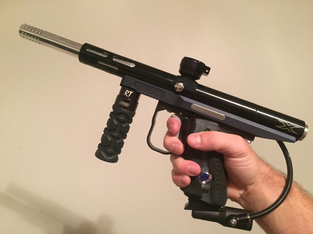

              Just got a Doc's Tanto barrel, myself. Aside from the fact that it's freaky, I also greatly appreciate the light weight and simplistic styling of it. Goes perfectly on an XMT ULE minimag body.
              Love, love, love this gun! So damn light and comfy to hold. Took her out in this configuration for the first time last weekend. Big outlaw woodsball game. She Chuck Norris'd the living hell out of the other team for the first 2 games before I started feeling bad and switched over to my classic mag and ultimately my Phantom.
