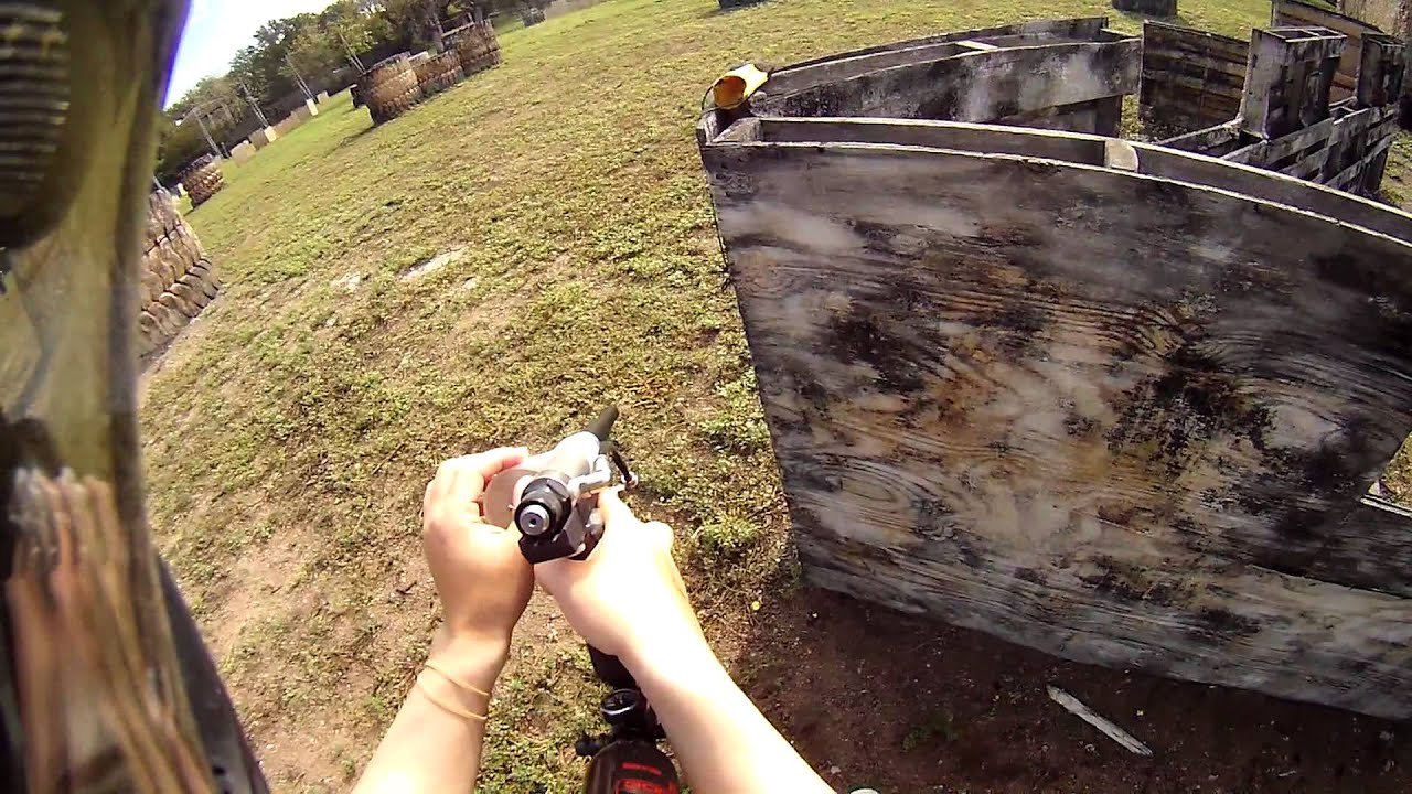

                        Test fired today:
                        Hah, max embedded videos per post is 1?
                        I need to find a better dump pouch as the current one is not good for rummaging around in.
                        So the thing is mostly complete.
                        I want a new back cover because the one from Shapeways came out somewhat deformed; a clear acrylic piece should be fine, and more importantly, actually be flat.
                        Need a new front cover because with enough pre-winds the spring will want to shoot out the front. I can have about 12 feet of prewinds because... the spring is actually harvested from a tape measure. So I should be able to pre-wind it like at the beginning of the day practically and not worry about winding in the field. Just load paint as I go.
                        And maybe I'll cobble something up to make the mount a little more secure.
                        But so far everything works as designed.
                        Oh, and the number of shots is technically a full six, however if I take that 6th shot without reloading then the 7th round goes slack, and is in danger of going in sideways (although the L10 bolt is excellent at catching it). So it's 5 shots with a 6th safety shot in the chamber.
                        Most of the time I'm single or double shotting people with regular paint, so I think this will suit my play style fine and defeat anyone trying to count shots against me.

                          awesome
                          keep us posted

                            This is great. I know you mentioned above you're not too interested in selling them yourself, but I'd love to see you run with the idea and somehow bring it to market. I'd buy one. Please do keep us posted

                                Neat concept but as is seems pretty impractical. Reloading time seems to be really high. Have you considered more of a "mag" concept?
