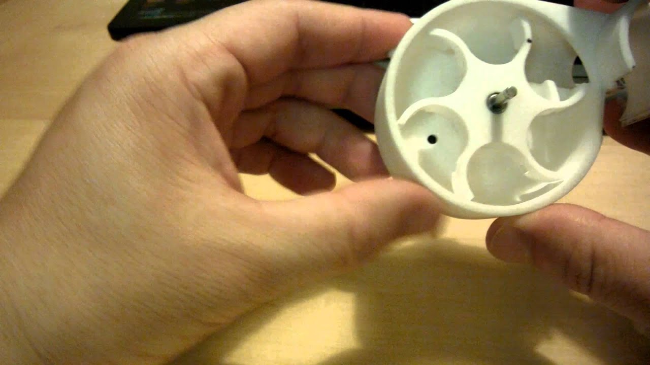

                Quick update on this... I set the project on the backburner to work on some other stuff, and quite frankly to wait for someone to do my work for me. And it turns out somebody in fact did happen to produce exactly what I was looking for.
                I added a planetary gear set on the front of the loader to fix some of the nagging issues that I had on-field. Namely, the gearing allows:
                1. Visual confirmation of prewind status, so I can know when I need to actually put more winds in. Not knowing the status seemed to lead to the majority of hijinx on the field.
                2. Overdrive so that I don't literally have to wind the full rotations with my hand. It's about maybe a 4:1 ratio or so (actually less; possibly 6:1), so I only rotate the annulus gear less than 1/4 turn to get a full rotation of the output.
                3. A rotation limiter to keep it from going into free-spin when empty. Since I now have visual indication and control of the winds, I can put exactly as many winds as I have rounds (more or less), so at the end when there are no more rounds, it will stop rotating. Like there will be a physical limiter installed.
                4. Minimal increase in size.
                So I retrofitted a v1 into a... v1.5. Note that it's not fully assembled so the bearing slips, but toward the end you get the idea of the overdrive.
                Eventually the spring carrier (not shown) will be integrated with the planet carrier, and I need to fix a slight oversight with the annulus...

                        I can top it off any time I want; that was a major feature that I wanted to have. The back cover rotates to access any empty chamber, any time, on a live gun that's still got rounds ready to go. So I can post on someone while reloading chambers with my off-hand. I've also reloaded it on the move; little tricky though.
