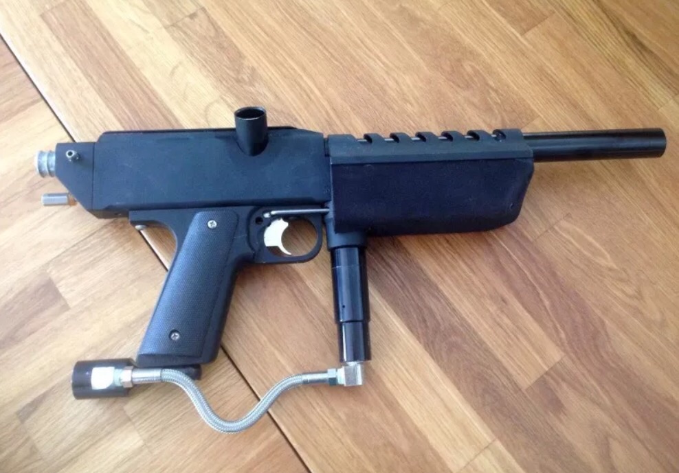

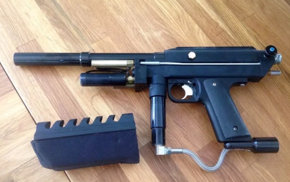

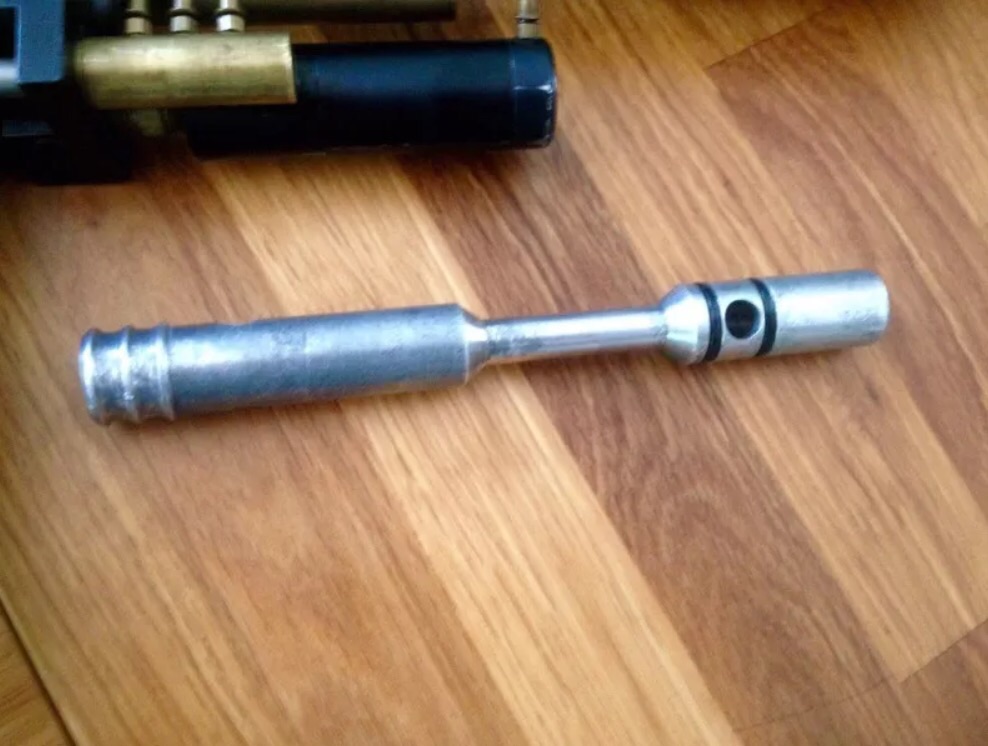

                        I've identified the gun I'm thinking of getting as a '99 Autococker (the shroud and the bolt both correlate to that particular year).

                        I think the nostalgia is taking hold. I mean, look at it! ...okay, so maybe it's just me.
                        A post-2K cocker or a Ressurection may very well be the smarter buy, but my priorities seem to be shifting more towards learning and discovery rather than performance. I almost prefer the handicap of a slower gun, actually. And I've never met a double trigger that I liked, and cocker hinge triggers look particularly ugly to me. Maybe pre-2K cockers are a pain in the ass to adjust but I'm still drawn. The 99's really had most of the kinks worked out, anyway. Right? I guess as long as air leaks and malfunctions are not a constant burden, I'm willing to give it a try. I repair hydraulic machinery for a living so the complexity issue doesn't really scare me - if a whole generation of cocker toting teenage kids who believed in the magic of closed-bolt range and accuracy could figure it out, I think I'll be ok.
                        I really intend on keeping this gun all stock, though. If I ever feel like I need better performance on the field, I'll look into a Ressurection or maybe build a post-2k custom cocker. That or I'll just grab something with an X-valve in it.
                          Ok, that is a stock 98/99 cocker with a benchmark 45. Looks clean and unmolested.
                          Kudos to you in not jumping into it and changing this and that cause you can. With that, i HIGHLY suggest reading, rereading, and then reading again, Ravi Chopra's Infosheet. Not only is the information contained in it is probably the best cocker reference, but is also more specific to your needs as the 99 cocker was the penicle or subject of it. MCB has a link as i am sure CC will have it as well.
                          A whole lot of what i know was gleaned from that and even 15 years after it was written, it still is the best.
                          But i will give you a head start. To adjust velocity, you need to do 2 things. How it is set in the pictures, you need to take out the cocking rod(the rod under the bolt on the back block), and turn in or out to change spring tension of the hammer opening the valve. It is a PITA. The other method is to change the air pressure through the HPR. So ditch that and play with it.
                          The stock pneumatics are stock. If they work, then you don't NEED to change them. Other than 4way orings, its a fire and forget kinda thing. Some actually perfer the stock pneumatics, as it is one less thing to muck about.
                          When you air it up, hold trigger and go for it. Going from mags to cockers, you will need to relearn how to pull the trigger fully again. It is practicing good trigger hygiene. That is nearly direct from Ravi Chopra. So enjoy it. There is nothing like a well tuned cocker, or just a cocker that just shoots. I know, itz heresy to say such things on AO, but its the truth. Totally different, yet equally rewarding.
