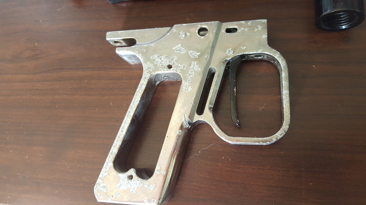

                  Love that 99. I'm still lusting at my brother n laws 96. But alas. I'm lazy so I'll stick with old faithful. I will say however though that in 2008 I got drug out to play with a friend. First time I had played since 03. I had my classic rt that hadn't been used since 03. And the aforementioned 96 cocker that hadn't been used since probably 99. Ironically my rt wouldn't cycle. Stuck air on the cocker and it cycled fine. So I played that day with the cocker. Granted all my mag needed was a new bumper as the OEM one had melted and turned to glue in storage. In the end it was the cocker that actually needed nothing to function that day. What I've seen over the years both markers can be very rugged. And as much as I love my mags. Nothing beats the look and sound of a well tuned old cocker.
                  • ghost flanker
                    mech warrior
                    • Mar 2006
                    • 365
                    #54
                    Thanks, blackdeath1K. At first, I wished that it still had the stock frame, but the benchmark is really quite comfy and matches aesthetically extremely well. Right now it cocks and fires simultaneously, but once I adjust the timing it's gonna be painting up some modern electro shooters just like my mags do.

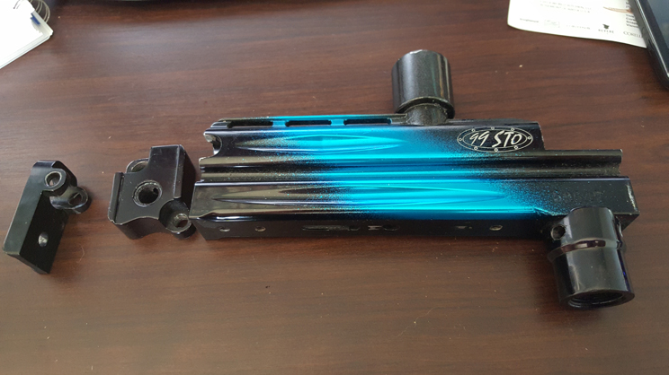

                      I have an Autococker body (99 STO) that I'm getting hydro dipped. It's seen better days, so why not.
                      Whoever had it before me used grease where they shouldn't have (or it was paint that has since solidified). The chrome on the grip is flaked off too:
                        #56
                        Adjust in/ shorten the timing rod or adjust the hammer lug out. You do want it close but still can drop the hammer before cocking, but also make sure that you are pulling the trigger fully. It is a 2 stage trigger and you need to complete the fire stage before the cocking stage.
