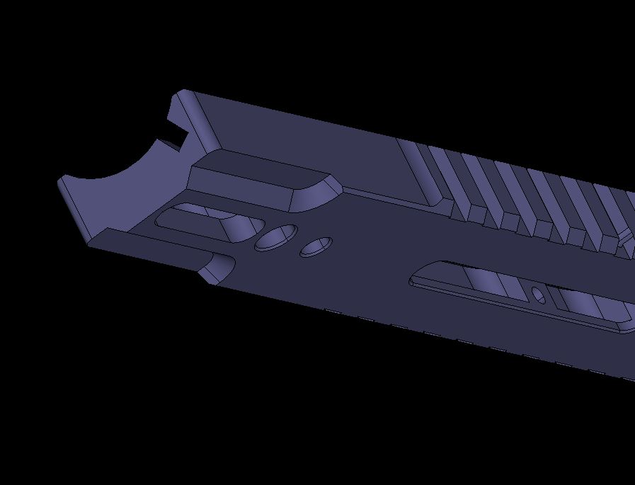

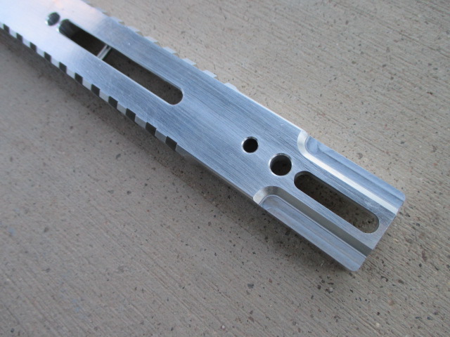

      For Walking Stick, I believe this is what you wanted.
      8" Tac Hybrid, pump milled, with AM bottom chamfer and AM FG slot.
Name:	8 in pump milled Tac 8.JPG
        Indeed it is! It will complement my Cerberus Tactical pump and 45elite frame perfectly. Thanks Luke!

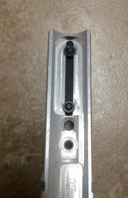

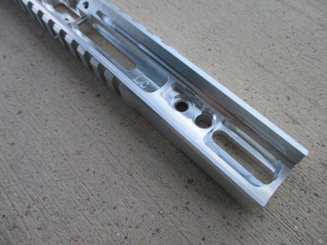

            Walking Stick>>

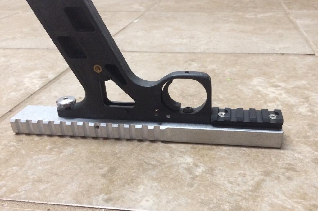

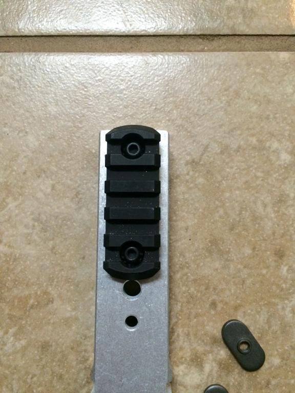

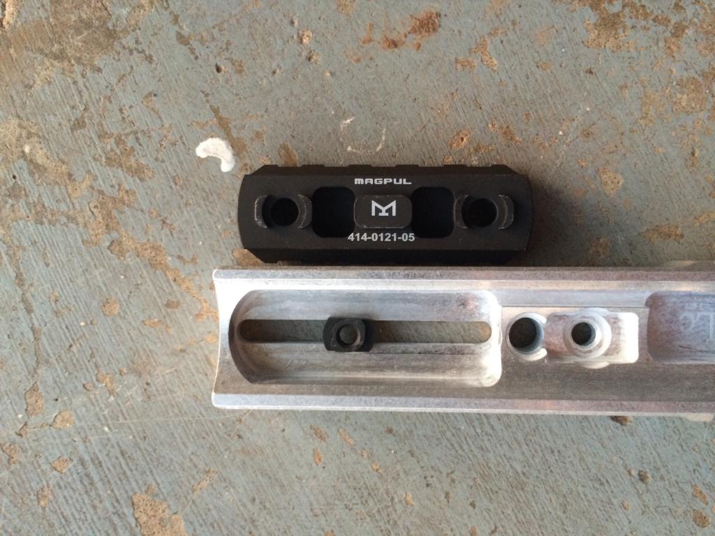

                  Got my 2!
                  Going tomorrow to get an m-lok tinny rail and see how it works.
                  I'll post pics.
                  Edit:
                  Couldn't wait till tomorrow...
                  I have MOE and M-Lok rails. Benefit to MOE is that they're flat on the bottom and so require no modding to use the rail.
                  Downsides to MOE are that they're being phased out and will soon be hard to find and the nuts for MOE are too wide to fit inside the UL'd area without modification.
                  Benefit to M-Lok is that they will be around for a long time (keymod is also phasing out) and the nuts are thicker than the MOE nuts.
                  The downside to M-Lok is that you either have to mod the rail section or widen the slot in Luke's rail to use it.
                  M-Lok

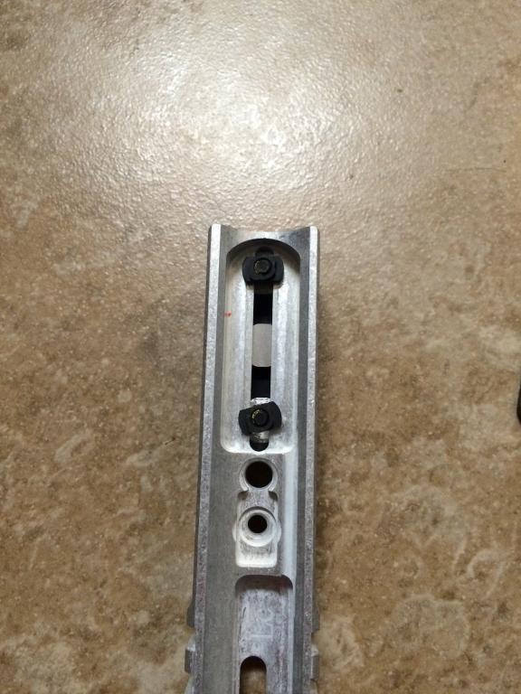

                  M-Lok and MOE comparison

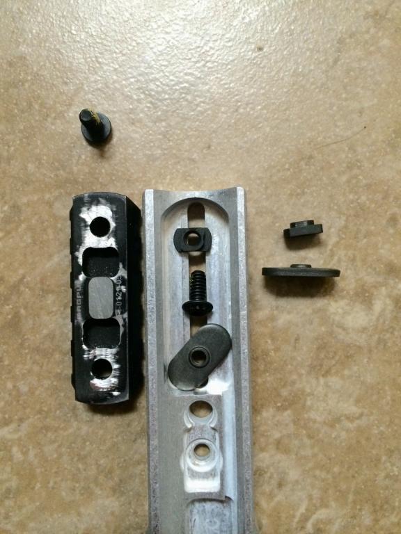

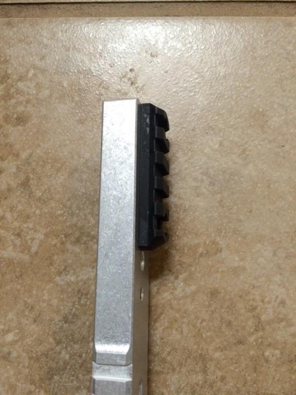

                  M-Lok rail section moded and installed

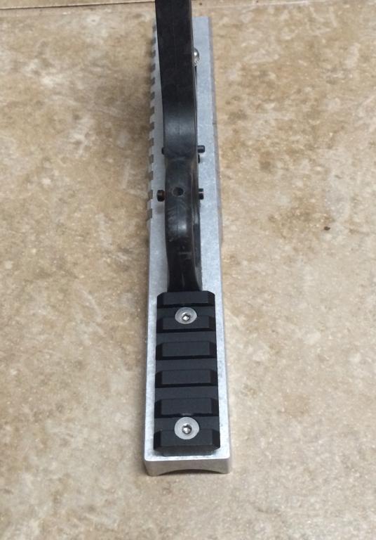

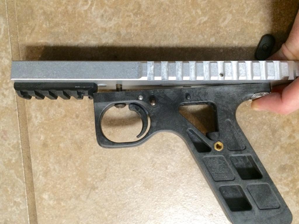

                      Went back to the gun shop and found a flat-nose rail section made by TWP.

                          Thanks for the idea bowcycle, I'm gonna go out and pick one up myself next paycheck.

                            This one is the keymod version in aluminum.
                            The slot in Luke's rail took a tiny amount of filing to get where the nuts could fit in the slot, but it really was only a tiny amount and it feels very secure.

                                What slot width do you recommend, I can make that adjustment for future rails?
