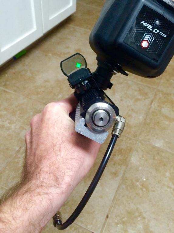

        The mp90 is tested but these parts were put together as a quick mock up.
          LMK after you test that setup.

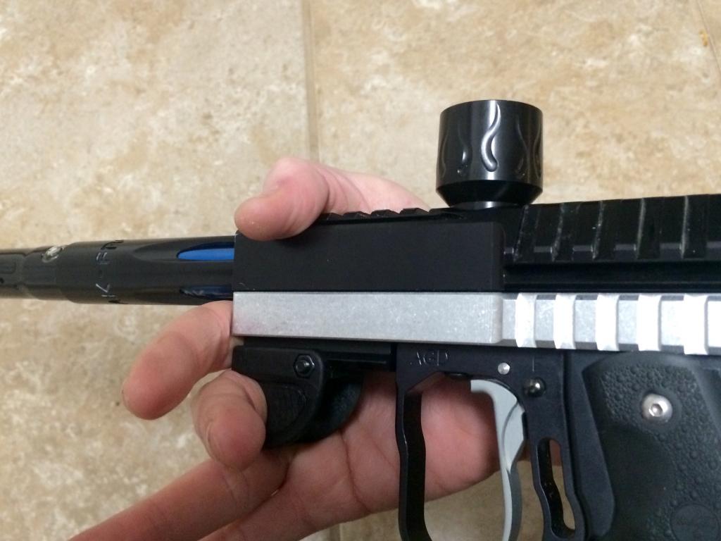

              What slot width do you recommend, I can make that adjustment for future rails?
              The internet says .234" is the width to receive the keymod nuts.
              What width did you cut these?
              It took barely any work with the files.
              I think Dano said the M-Lok requires a .276" slot.
              That was more work than I wanted to do to the rail, hence why I modded the M-Lok section instead on that first one.
                • 8239
                #397
                Yea, .234" is a little loose for a standard foregrip. It would work but I think I'll leave the current design alone and just let the guys file the slot if you want to run those parts. (BTW, I machine the RTP type slot at .200")

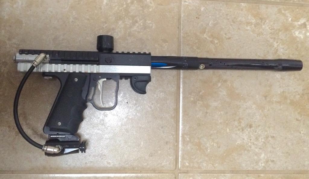

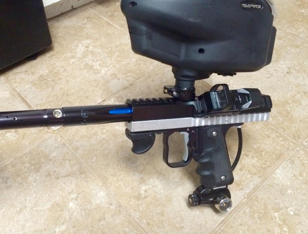

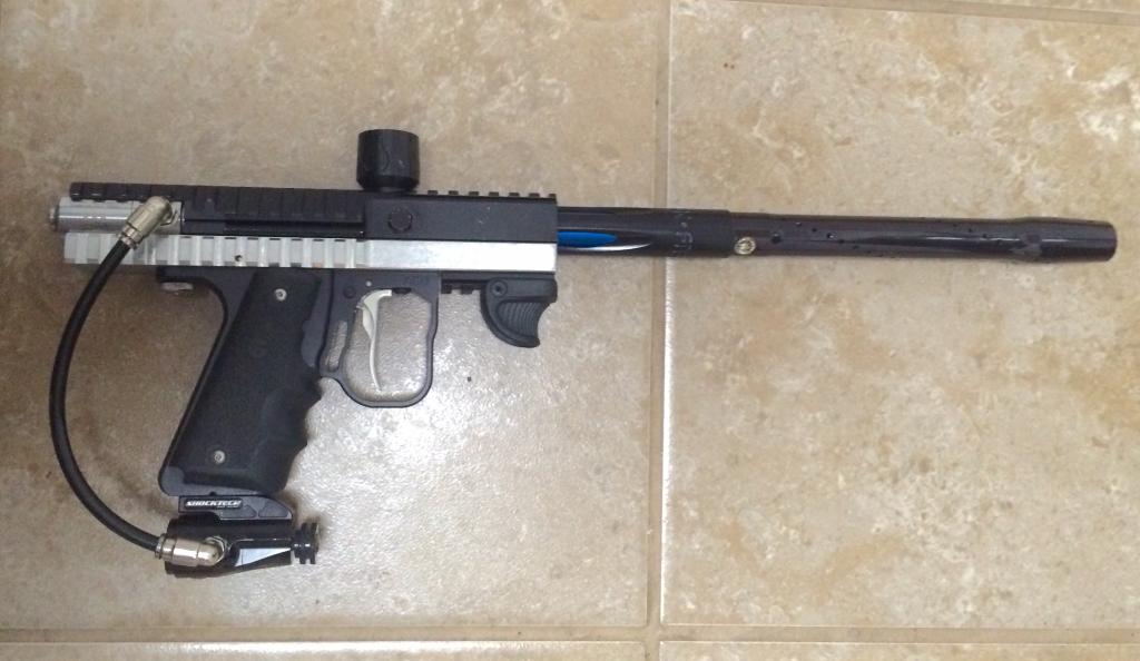

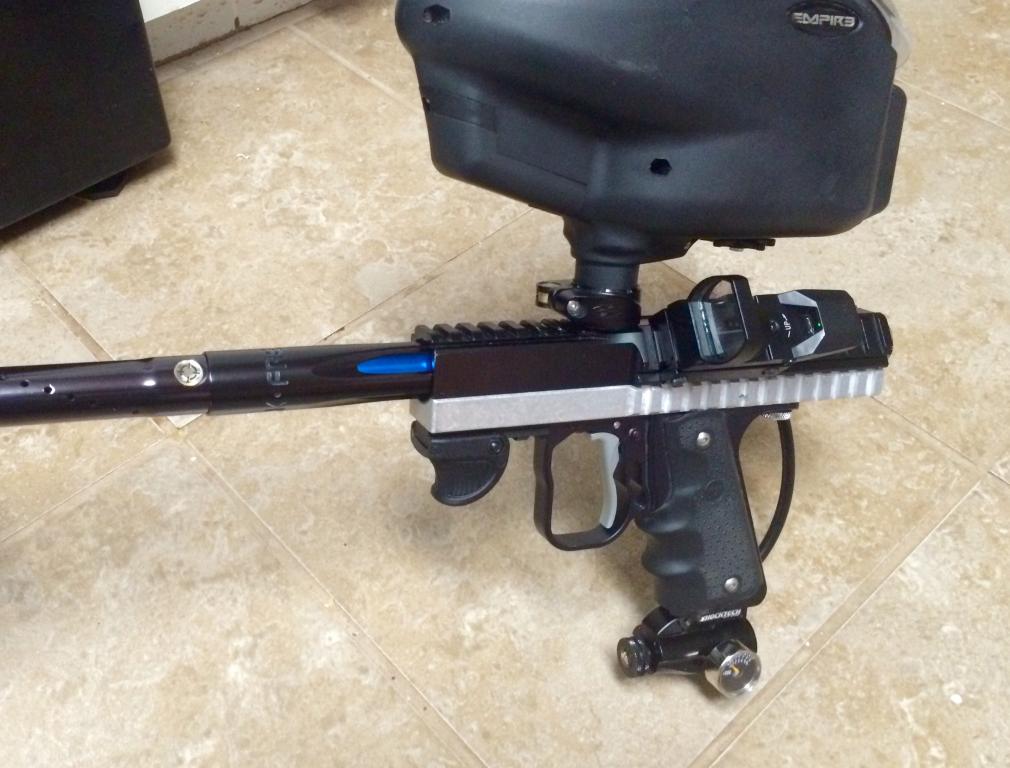

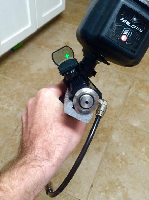

                                Here's my first build with the tac rail. You've probably seen this one in the BST, but that's only because I specifically bought 1 rail to build and sell. It's actually a lot of fun to shoot and I was surprised how well it works with a red dot on the angled rail.
                                Working on the keeper with my son and will have pics of it up soon.
