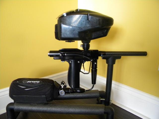

      Ok. Using a tape measure and accounting for my crappy eyesight, I am coming up with a measurement on my body from the front of the FS hole to the forward most part of the inside of the body I am coming up with 2 15/16". This is without the metal spacer/washer. I did put it back in for below.
      Just for good measure, I popped a battery in, aired up and went out in the backyard. 277, 280, 284, 284 etc. from me setting it probably 2 years ago. .682 freak back with Marbs and a DW CF barrel.
      Side note, man I forgot how much I love shooting this thing, but hate how quickly and how much fun it is to blow through a hopper of paint:
