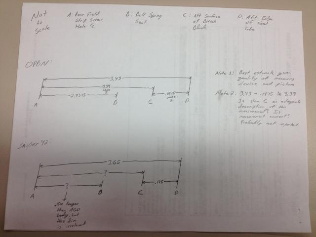

        #93
        We've known the primary issue since working bodies are around 3.5" from rear field strip screw center to aft edge of feed tube and sniper42's is 3.65".
        What the issue is now, is how to fix it. Dukie went in depth about something I had only touched on before - the breech bein machined wrong. With the latest measurements you and sniper42 provided, I do not think its the breech. I believe one of the three options I posted before (when you thought I was heavily caffeinated) will work, but it depends where stock exists to do machining. This is why I still want the measurements, in their entirety, from the other thread from working and non-working bodies alike.
        I still think a custom bolt might be the best option (does not affect external cosmetics), but I'm hoping someone else can figure out an easier way.

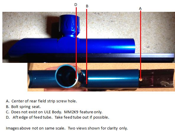

            #95
            This is the best I can do with the time I have available.
            1. Measure the following:
            A to B. From center of rear field strip screw hole to bolt spring seat (without washer).
            A to C. From center of rear field strip screw hole to aft edge of breech piece.
            A to D. From center of rear field strip screw hole to aft edge of feed tube.
Name:	MM2K9 Schematic.JPG
            Locations in schematic are approximate.
            2. Place two balls in the feed tube (positioned vertically) without a hopper. Shoot the bottom one, and report what the top ball does (flies out of feed tube, feeds properly, jostles a bit, etc.). Try to quantify if possible. For example, it flew 2 feet out of the feed tube.

              #96
              Originally posted by OPBN
              I would still like to see a side pic of Snipers marker. What if as someone else mentioned, bottom milling is just off? He says the "body hole" is longer, exactly what does this mean? I still say we need a pic/diagram fo the body and bullets or whatever showing exactly what needs to be measured to make sure we are all comparing apples to apples.
              Bottom milling being "just off" is a bad thing. This would mean trigger frame screws, sear slot, and sear axle holes all need to move. Not the easiest fix in my opinion.
              "Body hole" is the "A to B" measurement in the schematic I uploaded. At least, that's what I took it to mean.
              Last of the Salzburg Clan

                  #98
                  Originally posted by nak81783
                  Is my schematic going to suffice to get measurements from everyone?
                  -Mr. Snippy (I hope this isn't an omen for things to come after the bun in the oven is born)
                  Should be for me. Do we need to specify what to measure in a standard body to confirm we are comparing apples to apples in the case the both my working body and Snipers non-working body come up with the same measurements?
                  When I got a twofer the second pregnancy its what I went in and got.....

                    #99
                    Measure away!
                    On a ULE or other stock body, we're looking for the following:
                    A to B. From center of rear field strip screw hole to bolt spring seat (If we've all been measuring the same thing, this will have a wide range. It isn't critical.).
Name:	ULE Schematic.JPG
