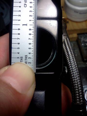

                      #85
                      Alright, I pulled my feedneck off and did some further gleening. On my MM2K9, the feed neck hole/port is not centered from front to back. It sits farther to the back of the breach than the front. Sniper or whomever else, where does yours sit? I am trying to measure it, but its a bit difficult because the edge of the hole is beveled inward.
                      The top of the pic is the direction towards the back of the marker.

                        #86
                        While the feed tube is out, shoot some balls with and without covering the feed hole to see if your velocity goes up as athomas suggested.
                        Last of the Salzburg Clan
                          #87

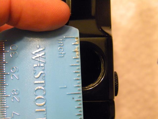

                            #88
                            The feed hole in mine also sits farther to the back. It looks to be about 0.175" from the back edge. In this picture the bottom of the picture is the back edge.
                            • nak81783
                              • Nov 2001
                              • 782
                              #89
                              Now we still need from center of rear field strip screw hole to start of breech slot on the main body piece for both markers, please. That should complete the puzzle.
                                #90
                                From the center of the FS screw to meeting of the back of the breach block is 3.39" according to my calipers.
