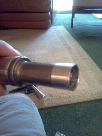

    And we have a winner. A longer bolt solved the problem. My first bolt I made from scratch was supposed to be a level 10 replacement but some dimension must be off because all it does is chuff. For the next one I decided to pick up a level 7 bolt from baccipaintball.com for a couple bucks. I turned the outside down and made a sleeve to extend the bolt by .150" and glued it on. I also put a screw in the front so the ball has something to seat against. I will glue some foam to this later.
    So far the results are promising. I was able to get up to 300fps before my velocity screw bottomed out. Before the new bolt, at about 240fps, I was getting enough blowback up the stack to launch a ball approximately 1.5 feet up. With the new bolt at 270fps I still have a bit of blowback but it is much less. It will only launch the next ball maybe 6 inches. So a sleeve that is maybe a tad longer might be in order.
    With my new bolt the face of the bolt is even with the back edge of the feedhole. Here is a crappy cell phone picture of the new bolt:

    So at some point I think I will have to get my hands on a spare level 10 bolt to make a sleeve for.

      Nice work! Just make sure you don't repeat the AGD Superbolt issue where the sleeves wore out, cracked, and came flying out the barrel. I think this was because they used delrin, but just keep an eye on it.

        can you make a sleeve for tha bolt you made to replace a lvl 10 bolt? have you figured out wat dimension/dimensions were off on that bolt?

          I had that thought. This one will be more of a proof of concept until I can come up with a more permanent one. The last thing I want is to shoot part of my bolt at someone.
