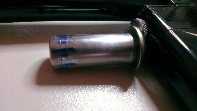

                            Hello, first time posting in this thread I think. I just dug my MM29K out of the storage bin to try to get it working again. I am only getting about 160 FPS with the E-Mag valve turned all the way up to almost venting. I remember at least getting 220-250 in the past.
                            I read through the thread, what stage are we at right now? Are we still measuring?
                            When I put a ball in the breech, and cover it with my hand, the velocity does not get any higher. I do not notice any excessive air escaping from the feed hole.
                            I did notice that my bolt tip is getting worn or damaged. If the breech or front block were to be mis-aligned, could the bolt hitting that at the end on the stroke, be causing the low velocity? I used a blue sharpie to draw lines all the way up to the bolt tip, notice how the top 1/8" of it is fully gone. Also, if you look carefully at the profile, you can see that the bolt has worn away the top 3/8" also, but the blue lines are still there, so that damage was before this last teching session. I had previously noticed this damage though, after I first tried getting the MM29K to work.

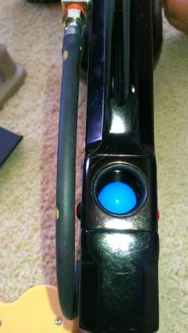

                              I went ahead and measured. My distances are:
                              A-B: 3 3/16" (3.1875")
                              A-C: 3 7/16" (3.4375")
                              A-D: 3 11/16" (3.6875")
                              I also noticed that there was a big gap between the bolt face, and the paintball, when the paintball is resting against the detent.
                              Looks like 1/4" or a bit more. Sounds similar to what sniper42 reported, so perhaps I have the same problem as him? My blowback is minimal though, without the feedneck, it barely pops the next ball up. With a feedneck, it pops the next ball up maybe 6 inches.
