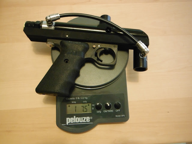

                            What are the weights of the various stock AGD markers produced over the years? I thought there were numerous pretty thorough threads on this, but searching isn't producing very good results.
                            I don't have a full list, although component part weights are easier to find.
                            I think the Classic came in close to 2lbs even.
                            I believe the X-Mag came in at 2.7lbs. The X-Mag has all kinds of fanciness in it, but it's "Abandon all hope" as soon as you put the aluminum grip frame with the solenoid + the battery on there.
                            I'm just gonna... leave this here.
                            I'd like an aluminum Classic as the X-Valve is still lighter than my Vigilante-valve setup by almost an ounce, but let's face it -- it's not happening.
