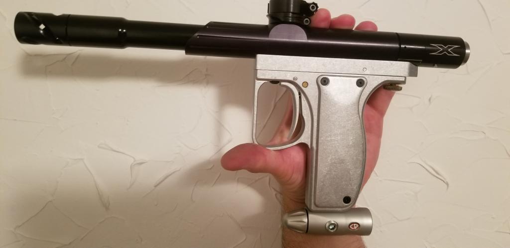

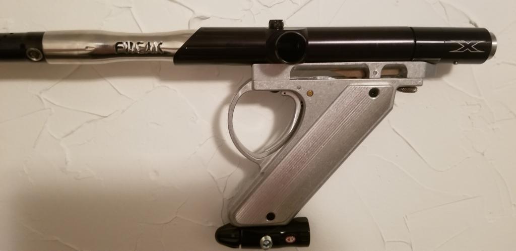

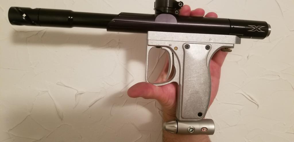

                      I dont get what the emag deal is, but I thought I'd dump this here: Oh, BTW, I bought 3 and I'm buying 3 more this week of the newer designs. I thought part of the point was that this platform makes it easier to do small batches... 4 here, 8 there, etc. Kinda like sluggo bodies: use the same base to make kartas, dallaras, etc.

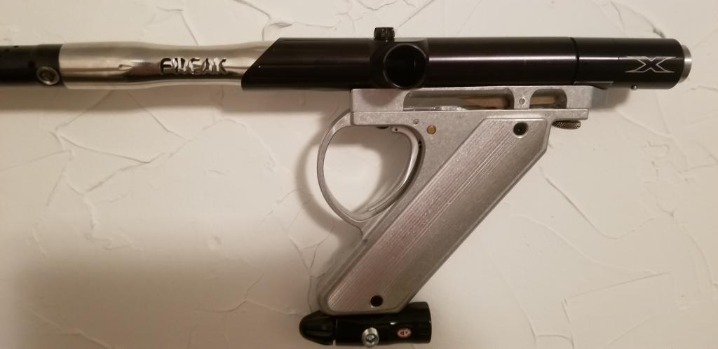

                        [ATTACH=CONFIG]100236[/ATTACH]
                        Holy Thumbscrew gap, Batman!

                          Well I've always had slug rails but before I had to stock Automag and RTPro slug rails. Plus some AM designs were not available in the RTP version because they just looked bad. The Hybrid platform solves inventory and design issues all in one, and they just look better than both AM and RTP rails.
                          Your correct about the small batch too, I have streamlined rail production to the point I can offer a bunch of different designs and keep only a few of each on the shelf (I was doing this before too). When I run out or run low I can pull slug rails and replenish the supply a little at a time. This is part of the reason that makes it difficult to offer anodized parts. I would have to commit to a few designs and hope they sell, this way I can just make whatever is selling the best at the time (it constantly changes). It takes the guess work out of the equation and allows me to offer options and custom rail designs.
                            I think its just a mock up, the thumb screws do sit flat on that frame, I would wager a dollar there's no rail bushing in that setup.
                              Yeah, whipped it together so fast I forgot the rail bushing! I'll put it together again tomorrow and see. Its probably why the valve looks a little crooked in this one too (thought it was just lens distortion at first):

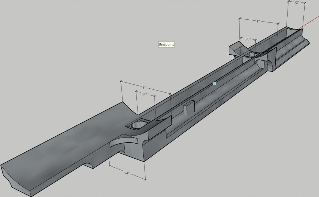

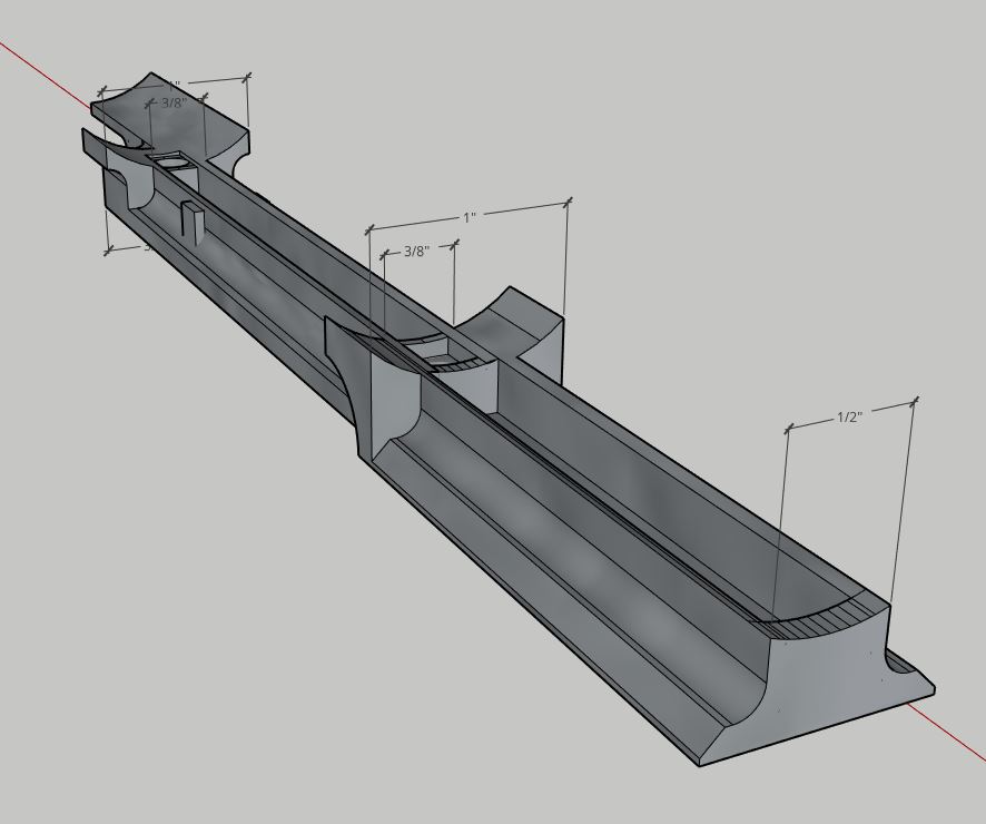

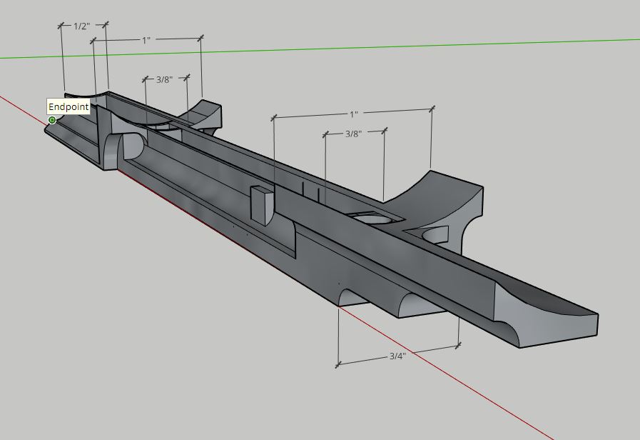

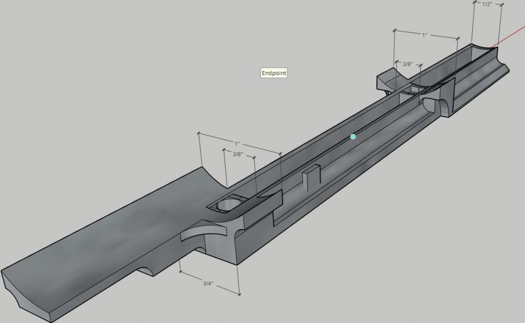

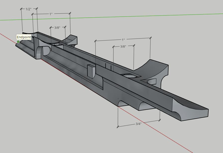

                                I'll need the length measurements, preferably pulled from center line of the thumb screw and front grip screw holes, forward and back.
                                If anyone wants one of these speak up. I'll probably only make these once, they wont be a stock item, and I doubt I'll make extras...
