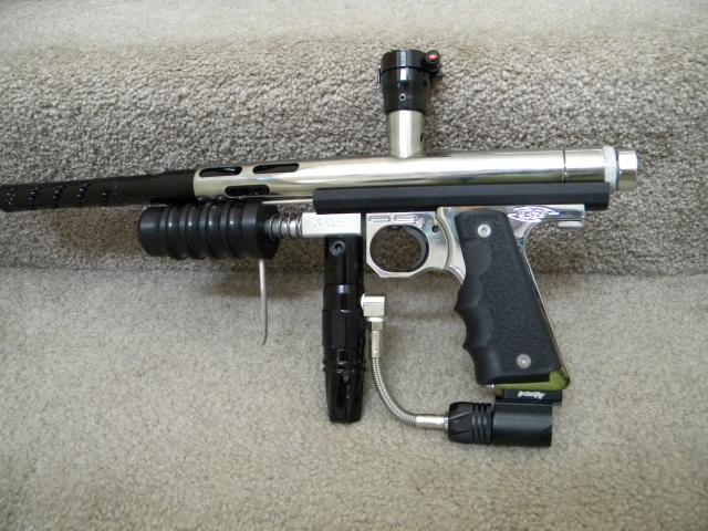

                  I'm not an airsmith, so I don't really know if it would or not. There is some open area inside the cap. I wasnt sure if this acted like a volume chamber. There is some formula for figuring this out. Either way, it wouldn't think it would require that much higher input. But I really don't know. My thinking that you already have the are between the VASA and valve and since the center air passage is now 1/8" instead of the 1/16 or so that it is now, it would make up for any volume lost. Currently my setup is requiring about 575 psi or so from the inline reg to get FPS in the proper range.

                        What I have is a older AKA Sidewinder. An AKA 2K+ I beleive will work as well. Has to be the "+". On the pump pictured I am using a Bob Long reg. I think its a Torpedo, but it looks different than the other ones I have seen. But basically, yeah you would need a 650-700psi output regulator.
